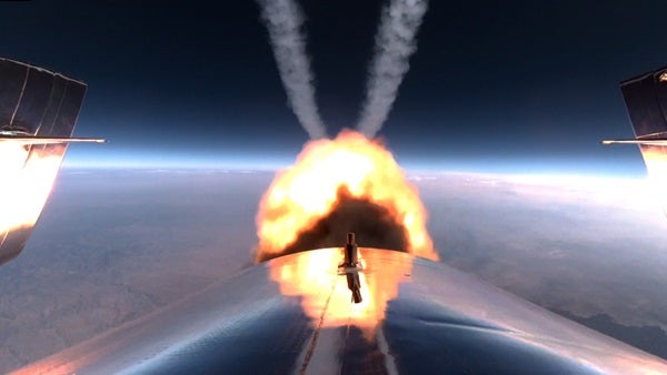

Virgin Galactic’s Unity VSS spacecraft went on a suborbital test flight in May 2021.

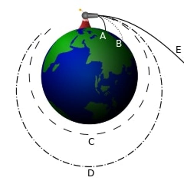

Suborbital flights (paths A and B) reach space, but because they aren’t moving fast enough over the Earth, gravity will pull the object back to the surface.
