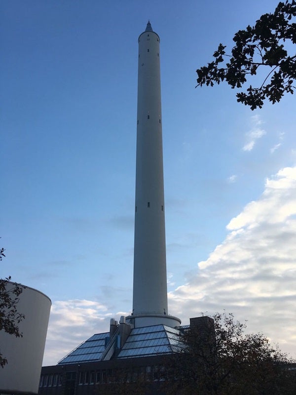

BremenDropTower1
Experiments placed in a drop casule and dropped down the Bremen Drop Tower can experience 9.3 seconds of microgravity conditions.
Katharina Brinkert
Microgravity on Earth
Caltech chemist Katharina Brinkert wants to tackle this challenge. So she and her collaborators devised an experiment to make light-powered, fuel-producing chemical reactions happen inside Germany’s Bremen Drop Tower. The drop tower gives scientists just 9.3 seconds of microgravity.
Brinkert wasn’t sure if their experiment would actually work in that little time.
“Doing electrochemistry is already difficult,” Brinkert says. “Doing it […] in 9.3 seconds is even more difficult.” Happily, the experiments were a success, and Brinkert and the team were able to produce hydrogen gas — a valuable fuel source — from a water-based acid solution.
