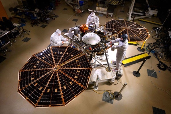

Engineers prep NASA’s Mars InSight lander for launch to the Red Planet.
