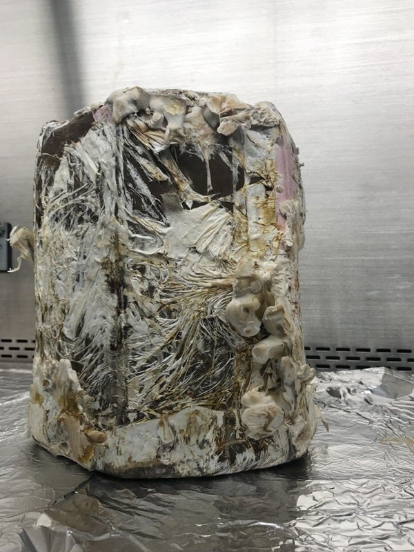

Stoolmadeofmushrooms
It may not look that appealing, but researchers were able to “grow” their own stool made of mycelia, seen here, in just two weeks. After the fungal furniture fills out its desired mold, researchers bake the piece to solidify and sterilize it.
Stanford-Brown-RISD iGEM Team
