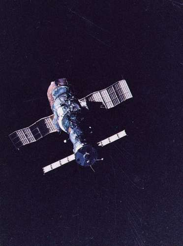

A cascading electrical failure
In February 1985, after hosting three cosmonaut crews (including one that stayed for 237 days, a record at the time), the vacant Salyut 7 space station started to experience trouble. Workers in the TsUP (the Soviet version of NASA’s Mission Control) noted that an overcurrent had tripped a circuit breaker, which shut down the station’s primary long-range radio transmitter.
Ground controllers switched Salyut 7 to its backup transmitter, which seemed to solve the problem — at least for a bit. However, a subsequent attempt to restart the primary transmitter created another overcurrent that started a cascading series of electrical failures. Both radio transmitters (primary and backup), as well as the station’s radio receivers, ceased to work.
Attempts to revive the station from the ground failed. Salyut 7 went silent. It began to slowly tumble.
