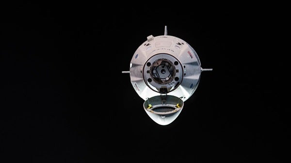

SpaceX’s Crew Dragon spacecraft opens its nose cone before docking with the International Space Station on March 3.
