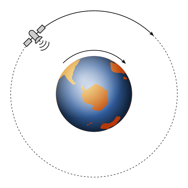

A common case where spacecraft controllers use aerobraking is when changing the craft’s orbit from a geostationary orbit (GEO) to a low Earth orbit (LEO). A GEO orbit is a circular orbit with an altitude of roughly 22,236 miles (35,786 km). In GEO, the spacecraft makes one orbit around Earth in 24 hours, so the spacecraft always stays above the same point on Earth’s surface.
In GEO orbit, a spacecraft orbits with Earth and stays above the same point on the surface the whole time. MikeRun/Wikimedia Commons, CC BY-SA
Before aerobraking, the spacecraft’s onboard propulsion system thrusts in the opposite direction of the GEO orbit’s motion. This thrust puts it into an elliptical orbit. The craft passes through the atmosphere multiple times, which eventually circularizes the orbit.
