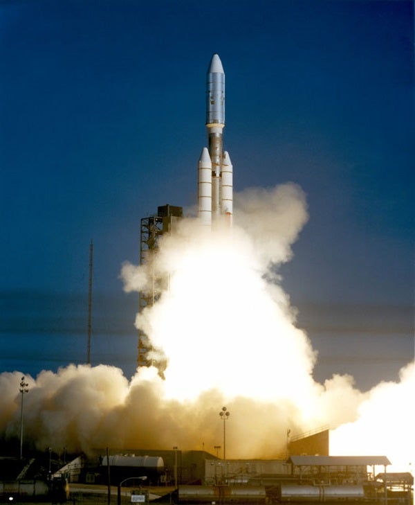

632pxTitan_3E_with_Voyager_1
Voyager 1’s launch was almost the end of the mission, instead of the beginning.

As Mission Control counted down the seconds until launch, a nasty surprise waited in the Titan second stage’s fuel system: a leak, small enough to have been missed in pre-launch inspections, but big enough to potentially doom the mission. By the time the team on the ground discovered the problem, Voyager 1 was already on its way to space, with the Titan rocket’s second stage short about 1200 pounds of propellant.
That meant the spacecraft might not make it into a high enough orbit around Earth for the maneuver that would break it away from Earth’s gravity and set it on a course for Jupiter. It looked like Voyager 1, instead of exploring the outer Solar System, might never leave Earth orbit — the spacefaring equivalent of running out of gas before you’ve left the driveway.
If Voyager 1 didn’t make it, its sister ship, Voyager 2, which had launched about two weeks earlier, would have shifted its course, skipping its flyby of Uranus and Neptune in favor of getting a closer look at Saturn’s largest moon, Titan. Activating that backup plan would have cost science the only mission to ever closely observe our solar system’s ice giants.
Voyager 1’s third-stage Centaur rocket carried a little extra propellant, but as it left Earth’s atmosphere behind, no one was sure whether that would actually be enough to make up for the leak. And the stakes were pretty high; if you run a rocket’s propellant completely dry, the fuel pumps can explode, taking the rocket and its payload with them. Voyager 1 could go from getting stuck in Earth orbit to becoming a cloud of space debris for future missions to dodge.
In the end, the Centaur had just enough fuel to make it. When Voyager 1 achieved its planned orbit, it had just three seconds’ worth of fuel to spare. That’s a thin margin on which to hang a flagship mission, but it worked. A fourth rocket stage, built into the Voyager 1 spacecraft itself, fired to put Voyager 1 on course toward Jupiter. The rest is history: a mission that changed our view of the outer solar system, raised new ideas about where to look for liquid water and life, and paved the way for the Galileo and Cassini missions to Jupiter and Saturn.

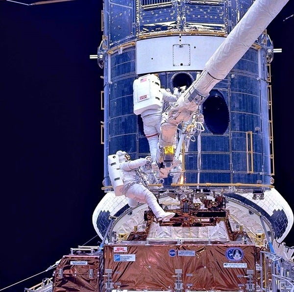

Upgrading_Hubble_during_SM1
Astronauts install corrective optics to give the Hubble Space Telescope perfect sight.

NASA initially invested $1.5 billion in the Hubble Space Telescope. Several astronomers invested most of their careers in it, and others bet their professional futures on the data it promised to send home; Jim Gunn, for instance, spent 15 years designing the Wide Field and Planetary Camera, or WFPC 1. And then, shortly after its deployment in 1990, the first images came back blurry and totally unusable. The telescope was already in orbit 350 miles above Earth, so bringing it down to diagnose and repair the issue wasn’t an option, and the situation looked bleak (and fuzzy).
It took NASA a month of investigation to find the tiny problem that nearly doomed the enormous telescope. It turned out to have been lying in wait for nine years, since 1981: a miniscule 1.3-millimeter spacing error in an instrument used to guide the final grinding of Hubble’s 94.5-inch-wide primary mirror. The result was that the edges of the mirror ended up ground very slightly too flat — a difference of a fraction the thickness of a human hair. But it was enough to cause the mirror to scatter the light from distant objects, which produced fuzzy images surrounded by a halo-like blur. The telescope humanity had built to look farther out into the universe than ever before was nearsighted.
NASA engineers spent the next three years building a set of spectacles for the nearsighted telescope: five pairs of moveable, curved mirrors that would help correctly focus the light from Hubble’s main mirror as it passed into the telescope’s three science instruments. They called it the Corrective Optics Space Telescope Axial Replacement, or COSTAR. In December 1993, the crew of STS-61 spent 35 hours on five back-to-back spacewalks installing COSTAR and a new version of WFPC, which also helped counteract Hubble’s blurry vision.
The fix worked, and Hubble spent the next 16 years sending home crisp, clear images of the far reaches of space, studying exoplanets, discovering new moons of Pluto, and revealing the earliest galaxies in the universe. In 2009, the final shuttle mission to service Hubble replaced its science instruments with newer versions, with their own built-in corrective optics. Hubble didn’t need its spectacles anymore, so the astronauts removed COSTAR, making room for a new Cosmic Origins Spectrograph instrument.
