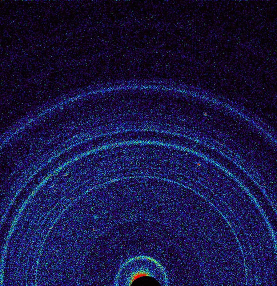

This graphic shows results of the first analysis of martian soil by the Chemistry and Mineralogy (CheMin) experiment on NASA’s Curiosity rover. The image reveals the presence of crystalline feldspar, pyroxenes, and olivine mixed with some amorphous (non-crystalline) material. The soil sample, taken from a wind-blown deposit within Gale Crater, where the rover landed, is similar to volcanic soils in Hawaii. The colors in the graphic represent the intensity of the X-rays, with red being the most intense. // Credit: NASA/JPL-Caltech/Ames

CheMin uses X-ray diffraction, the standard practice for geologists on Earth using much larger laboratory instruments. This method provides more accurate identifications of minerals than any method previously used on Mars. X-ray diffraction reads minerals’ internal structure by recording how their crystals distinctively interact with X-rays. Innovations from Ames led to an X-ray diffraction instrument compact enough to fit inside the rover.

“Much of Mars is covered with dust, and we had an incomplete understanding of its mineralogy,” said David Bish from Indiana University in Bloomington. “We now know it is mineralogically similar to basaltic material, with significant amounts of feldspar, pyroxene, and olivine, which was not unexpected. Roughly half the soil is non-crystalline material, such as volcanic glass or products from weathering of the glass.“
