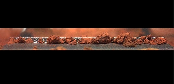

This image shows a microscopic view of fine-grained material at the tip of the Robotic Arm scoop aboard NASA’s Phoenix Mars Lander on June 20, 2008. The image shows small clumps of fine, fluffy, red soil particles.
