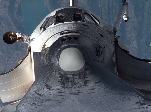

Discovery nose-on
Space shuttle Discovery as seen by astronauts on the International Space Station during a back-flip maneuver to image the vehicle’s underside.

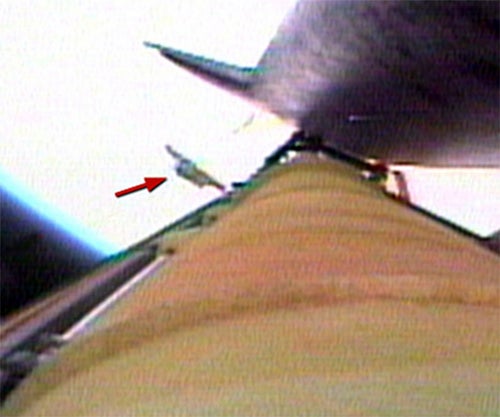

ET camera views debris
A new television camera on the external tank caught the largest piece of foam (arrow) as it fell away from the external tank. The debris did not strike the orbiter.

The largest piece of debris, measuring nearly a yard long, is thought to be a bit smaller than the suitcase-size chunk that struck and doomed Columbia in 2003. It peeled off the external tank a few seconds after the two solid rocket boosters separated, 2 minutes 5 seconds into the flight.
Images of the tank taken from the shuttle after they separated show a matching pillow-size gouge in foam along a feature called the Protuberance Air Load (PAL) ramp. This structure eases air flow around cables and pressurization lines running along the tank.

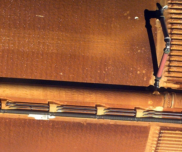

ET missing foam
Images from Discovery after it separated from its external fuel tank following launch on July 26 were transmitted to the ground July 27. A pillow-size piece of foam (white area, lower left) separated from the tank during the shuttle’s ascent to orbit. A small divot (upper right) appears near the bipod, which attaches the tank to the orbiter.

Discovery docked with the International Space Station (ISS) at 7:18 A.M. EDT this morning. During approach, Commander Eileen Collins and Pilot Jim Kelly manually guided the shuttle through a back-flip so astronauts on the station could image the craft’s thermal-protection tiles in detail. STS-114 is the first shuttle mission to visit ISS since STS-113 left in December 2002.
“Everything that we see at this point says that the orbiter is in fact a clean bird,” Griffin told ABC’s Good Morning America after the maneuver.
