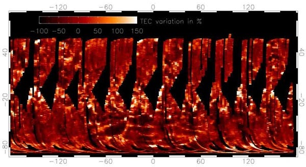

This figure is a map of the TEC in the Martian ionosphere, created with data from the MARSIS, onboard Mars Express. The vertical scale indicates latitude (y-axis) and the horizontal (x-axis) is for longitude.
ASI/NASA/ESA/Univ. of Rome La Sapienza/Univ. of Iowa/JPL
The distribution of the TEC has been determined by using a novel transmission-mode technique to sound the ionosphere, instead of the more common reflection-mode. In the transmission mode, the radar transmits a pulse that travels through the ionosphere twice, once on the way down to the surface and again on the way back.
The received echoes are weakened, delayed and dispersed, depending on the electron density in the ionosphere directly below the spacecraft. In the process of correcting the radar signal, the team has been able to estimate the TEC and its global distribution with an unprecedented spatial resolution of about 5 km.
“We have been able to analyze the MARSIS data to obtain the first large-scale coverage of the ionosphere above the planet’s night side,” said Ali Safaeinili of NASA’s Jet Propulsion Laboratory, lead author on a scientific paper presenting the new results. “The ionosphere on the night side of Mars has never been mapped before.”
The mapping of the geographical variations in the night side TEC data reveals an intricate web of regions with high electron density. One of the most interesting discoveries has been the close correlation between the number of electrons in the night-side ionosphere and the direction of the local Martian magnetic field.
“We confirmed that the regions of high electron density are associated with strongly magnetized areas, especially south of the equator, near places where the magnetic field lines are perpendicular to the surface,” said Wlodek Kofman of the Laboratoire de Planetologie de Grenoble, co-author on the paper.
