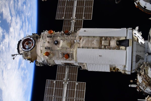

The Russian laboratory module Nauka docked with the International Space Station on Thursday, seen here in a photograph taken by crew aboard the station.

The module, a laboratory named Nauka, had docked with the station on Thursday morning. Roughly three hours later, at 12:34 P.M. EDT, as the crew prepared to open the module’s hatch, the station’s attitude (or orientation) began drifting. The astronauts reported that they could see Nauka’s thrusters firing. At 12:42 P.M., Mission Control declared a loss of attitude control. Control authority of the station was then handed off to the Mission Control Center in Moscow, which called the station’s Russian-built Service Module into action, firing its thrusters to counteract the stuck thruster on Nauka.

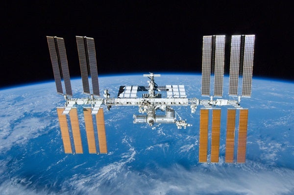

The International Space Station weighs approximately 420 metric tons (925,000 pounds).

Thanks to the efforts of the thrusters on the ISS Service Module and Progress — and because the ISS has a much greater mass and moment of inertia than the Gemini capsule — the station didn’t reach anywhere near that rate. It peaked at about half a degree per second, which would have seen it do a 360-degree spin in 12 minutes. But for a facility as massive as the ISS, it was a harrowing incident.
