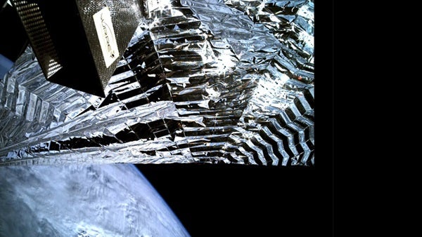

Icarus-1, a drag sail developed by Cranfield University, was launched to space aboard TechDemoSat-1 in 2014. After the satellite reached the end of its life in 2019, it was deployed to accelerate the craft's reentry.
Icarus-1, a drag sail developed by Cranfield University, was launched to space aboard TechDemoSat-1 in 2014. After the satellite reached the end of its life in 2019, it was deployed to accelerate the craft’s reentry.

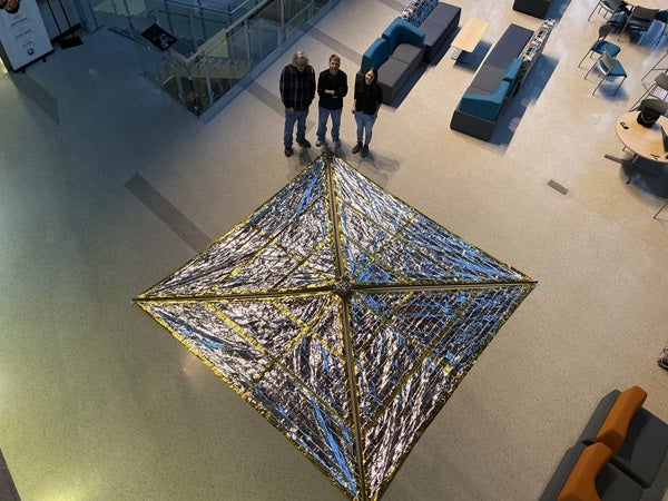

Spencer’s team turned to badminton for inspiration. Their Spinnaker-1 sail model takes the shape of a pyramid once it’s deployed. “That pyramid acts like a shuttlecock would,” says Spencer, which automatically turns the vehicle to the orientation that provides maximum drag.
Three people with a fully-deployed drag sail in a building atrium, as seen from a drone
Purdue University’s Anthony Cofer, David Spencer, Arly Black pose with their drag sail prototype Spinnaker3.
