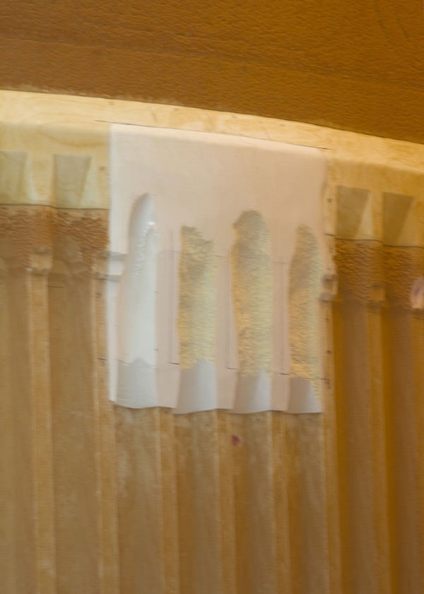

The Program Requirements Control Board met and reviewed engineering evaluations associated with cracks on two 21-foot-long, U-shaped aluminum brackets, called stringers, on the shuttle’s external tank. NASA repaired the cracks and reapplied foam to the exterior of the stringers.
Managers decided the analysis and tests required to launch Discovery safely are not complete. They are planning to conduct an instrumented test on the external fuel tank and structural evaluations on stringer test articles to determine if the analysis is correct. Details and timelines for the tanking test are in process, but plans call for temperature and strain gauge measurements in the intertank region near the top of the tank during the test.
The test also will verify the integrity of repairs made earlier when two cracked stringer sections and foam were replaced. A team of engineers and technicians will inspect the tank for evidence of any foam cracking as it would on an actual launch day. The test also will verify the integrity of repairs to the Ground Umbilical Carrier Plate, which leaked an unsafe amount of gaseous hydrogen during Discovery‘s November 5 launch attempt. The date of the test is under evaluation, but likely will occur this month.
Engineers will continue to search for the root cause of the stringer cracks through data analysis and tests, including placement of manufacturing defects in separate stringers to demonstrate structural integrity in an effort to duplicate the same type of failure that occurred in November.
