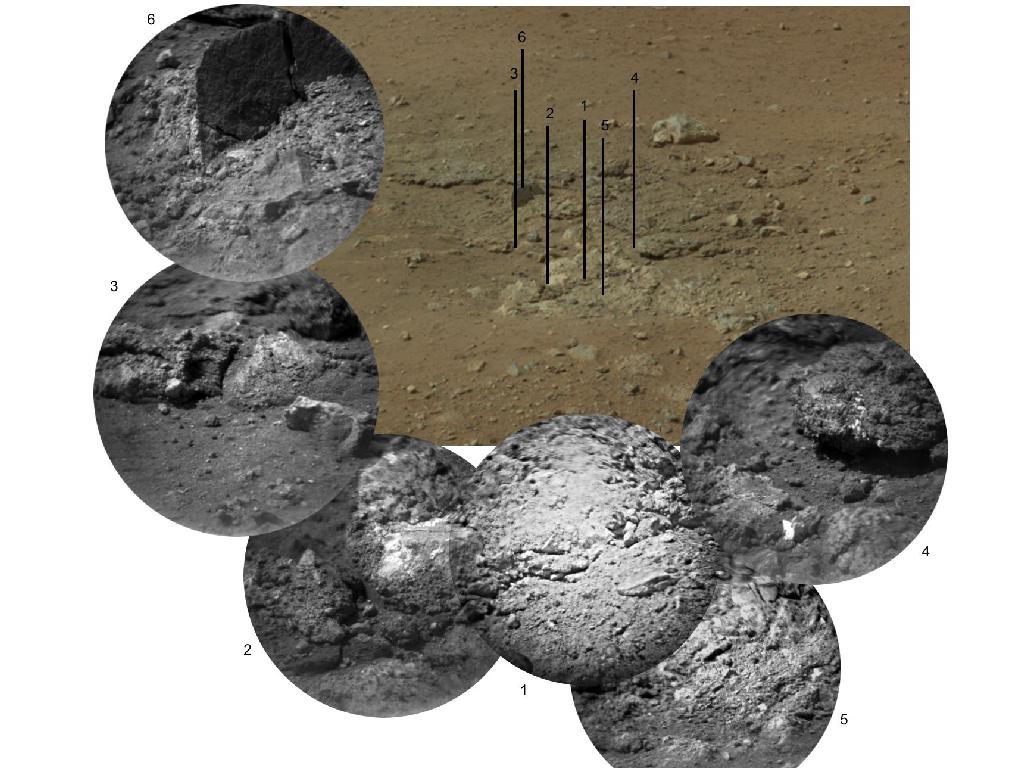

This photo mosaic shows the scour mark, dubbed Goulburn, left by the thrusters on the sky crane that helped lower NASA’s Curiosity rover to the Red Planet. It is located 16 to 20 feet (5 to 6 meters) to the left of the rover’s landing position. The sky crane appears to have uncovered an outcrop of loosely consolidated rocks during the rover’s landing. The mosaic consists of six images from the remote micro-imager (RMI) on the Chemistry and Camera (ChemCam) instrument, shown around an image from the Mast Camera for context. Each RMI image has a field of view of 4 to 5 inches (10 to 12 centimeters) across and shows details as small as 0.02 to 0.03 inches (0.5 to 0.6 millimeters). ChemCam’s laser was used to analyze material at the centers of panels 2, 3 and 4.

“After Coronation, we got to shoot at a group of ugly-looking rocks in the area named ‘Goulburn,’” Wiens said. “That is one of the areas near the rover that was blasted by the thrusters of the landing vehicle, but these rocks were much farther away from the rover than Coronation, providing a bit more of a test for the ChemCam’s laser.”
