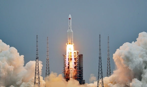

A Long March 5B booster lifts off April 28, carrying the core module of China’s next space station.
CNSA

The 20-ton Long March 5B booster launched on April 28 from the Wenchang Spacecraft Launch Site on Hainan Island, off the southern coast of the Chinese mainland. It was carrying part of what will be the China National Space Administration’s (CNSA) next space station, Tiangong, which means “heavenly palace.”
But after the rocket lofted a station module, dubbed Tianhe, to orbit, observers around the world noticed that the booster itself didn’t fall back down. The rocket achieved orbit, along with its payload, but it apparently has no way to deorbit itself in a controlled fashion.

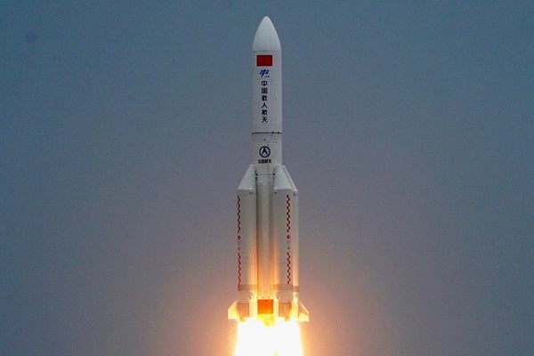

Most modern rockets launch in stages: Initial stages and booster rockets fall back to Earth, while final stages that carry payloads to orbit are designed to restart their engine and perform a deorbit burn. But the Long March 5B has a single core stage, augmented by boosters, that travels all the way to orbit with its payload.

The Long March 5B consists of a single core stage with four booster rockets arrayed around its fuselage.
CNSA
After the latest Long March 5B launch, McDowell criticized the design on Twitter. “This was not an accident, it was poor design of the rocket,” he said on Twitter. “The fact that the massive core stage stays in orbit is how this rocket is designed, and that’s the easy (but negligent) way to do it.”
