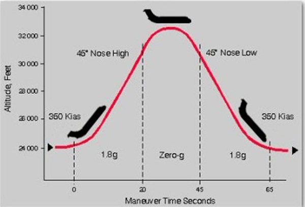

Flight trajectory for a typical zero-gravity flight maneuver.
C-9B Flight Trajectory, NASA Reduced Gravity Research Program

The shape of the vomit-comet flight path is called a parabola. Pilots achieve this by flying upwards at an angle of about 45 degrees and then they level out and dive at about 45 degrees, which creates the acceleration needed to cancel out gravity. The maximum speed for the airplane and how rapidly the airplane can pull up before and after a parabola determine how long this acceleration can last, about 25 seconds.
Gravity pulls down on us, and by accelerating down in just the right way in an aircraft or spacecraft, we can feel like we are in zero gravity. The correct physical term is weightlessness, but zero gravity is a descriptive term that also describes the sensation, so even in the aerospace research world and in NASA, “zero gravity” is the common term used most often by experts.
