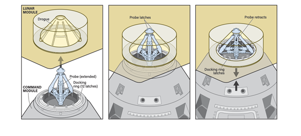

The maneuver seemed to come off as planned. But when the CM docking probe made contact with the drogue mounted to the LM, the probe’s spring-loaded latches failed to snap into place. Roosa applied forward thrust and made contact a second time, but it still didn’t latch.
Roosa: OK, Houston. We’ve hit it twice, and sure looks like we’re closing fast enough. I’m going to back out here and try it again.
Fullerton: Roger.
Roosa’s third attempt also failed to latch.
Roosa: Well, there goes the record.
Mitchell: Don’t worry about it. Let’s get him picked up.
Roosa: OK. Man, we’d better back off here and think about this one, Houston.
After checking some circuit breakers to ensure electrical power was reaching the probe, Roosa readied for a fourth try. This time, Houston suggested holding forward thrust after contact for three seconds to try and secure the probe latches.
Roosa: And here we come in again.
Fullerton: Roger.
Roosa: 1, 2, 3, 4 — son of a b—-, nothing! OK, Houston. I hit it pretty good and held [forward thrust for] four seconds on contact, and we did not latch.
Fullerton: Roger. We’re seeing it all on TV here.
Roosa: [Sigh.] S—. [Garbled] one more time.
After a fifth try failed, Houston suggested that Roosa make contact with the drogue, continue to thrust forward, and, even if the probe didn’t achieve a “soft dock,” retract the probe in the hopes that some of the 12 tunnel latches would snap into place.
Mitchell: About 6 feet out. [Pause.] About — 2 feet.
Roosa: About a foot. Here we go. OK, RETRACT.
Shepard: Nothing happened.
Roosa: Nothing?
Shepard: I don’t know.
Suddenly, the latches engaged in a series of loud snaps.
Shepard: I got — got a barber pole. [A diagonal-striped “barber pole” status indicator meant an action was in progress.] We got a hard dock.
Mitchell: We got some [latches], Houston.
Fullerton: Roger.
Roosa: I believe we got a hard dock, Houston.
Fullerton: Outstanding.
Roosa: We got it.
