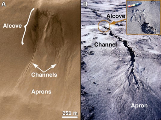

Gullies on Mars vs. Earth
(A) Gullies in the mid-latitudes of Mars with the three characteristics labelled: Alcove, channels, and apron. (B) A gully on Mount St. Helens, imaged by Michael C. Malin. Coloured bar is 30 cm long. Modified from MGS MOC Release No. MOC2-234.

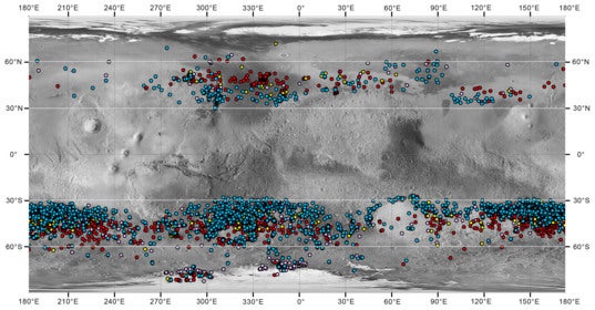

Map of gully distribution on Mars
Global distribution of gullied landforms as mapped using CTX data (covering ~85% of the planet at 6 m/pixel resolution at the time of mapping). Colors indicate orientation preference at each landform. Blue = poleward-facing, yellow = east/west, red = equatorward, purple = no preference.

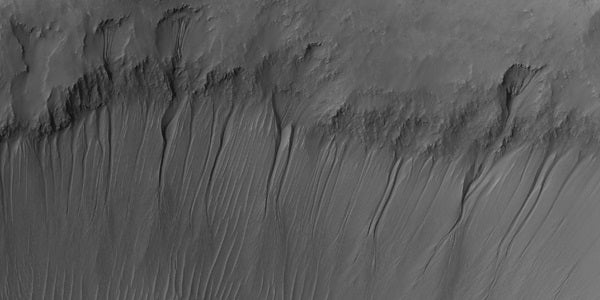

Dry mass wasting vs. gullies on Mars
The top row shows landslides with morphologies consistent with dry mass wasting in the equatorial regions of Mars, while the bottom row shows examples of gullies from Mars’ mid-latitudes.
