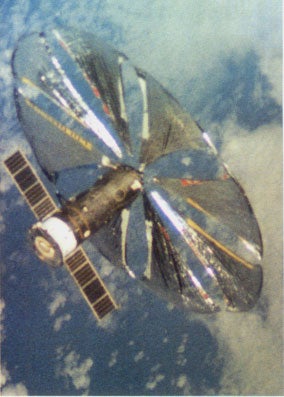

ZnamyaSatellite
The Znamya satellite deployed.
RKK Energia
If you want any more evidence that the plan might not be so sound, you need only look to Russia. Vladimir Syromyatnikov, an engineer who worked on the Soyuz-Apollo program actually tested out the concept of an artificial moon in 1994. Znamya, Russian for “banner”, was a circle of aluminum-coated plastic 65 feet in diameter that was launched from the Mir space station and unfolded in space like a fan.
The artificial moon worked — briefly. As The New York Times reports, astronauts aboard the station could detect a faint beam of light arcing toward the ground, though observers on Earth saw only a momentary bright glimmer in the sky.
A second test satellite ran into problems on deployment in space, and the project was abandoned. The original plan called for a fleet of the disks, each 650 feet in diameter, to provide constant illumination to the ground, though the problem of maintaining the orbits and accurately aiming the spacecraft was never functionally addressed.
