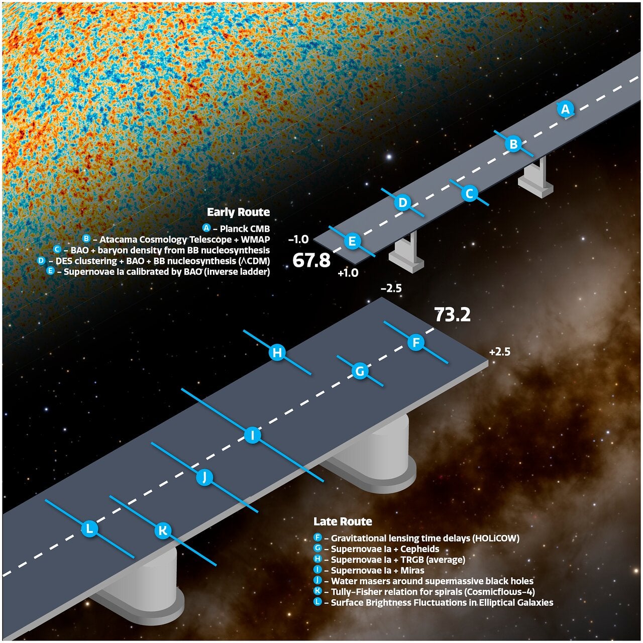

The problem is that when we look around the local universe, the universe seems to be expanding faster than predicted by the current models that govern physics. This gap between what models predict and what is actually observed has become known as the Hubble tension.
For years, the Hubble tension has been a vexing reminder to scientists that something is not quite right in their models. But with the new observations of the Coma Cluster — which lies practically in our own backyard by cosmological standards — scientists say the discrepancy stands out more glaringly than ever. “The tension now turns into a crisis,” said the paper’s first author, Daniel Scolnic of Duke University, in a press release.

This value is an excellent match to other independent measurements of the Hubble constant that are based on looking at objects in the nearby universe.
But it only exacerbates the tension with the expansion rate predicted by the standard model of cosmology, known as the Lambda Cold Dark Model (ΛCDM). To calculate the model’s predictions, scientists begin with observations of the light radiated from after the Big Bang, known as the cosmic microwave background (CMB). Then, they use ΛCDM to extrapolate forward through time. But this approach yields a present-day Hubble constant of only 67.4 km/s/Mpc.
The new Coma Cluster distance measurement’s solidification of the much higher value suggests that the root of the Hubble tension lies within ΛCDM itself — not a error in measurement. “We’re at a point where we’re pressing really hard against the models we’ve been using for two and a half decades, and we’re seeing that things aren’t matching up,” Scolnic said in a press release.
