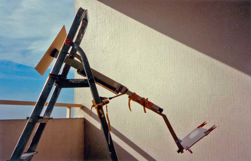

One of the simplest and least expensive ways to dive into solar observing is to project the Sun’s image onto a white backdrop. Use the scope’s shadow to align the Sun — do not look through the instrument. // Michel Huet

First, there’s solar projection — using a telescope to project the Sun’s image onto white cardboard or a sheet (see the photo above). With a low-power eyepiece in place, point your scope sunward; use the scope’s shadow — not the finder — to aim. You’ll know you’re on target when sunlight illuminates the eyepiece. Position the cardboard a foot or two from the eyepiece, and focus until the bright circle of light (the projected image of the solar disk) is sharp at the edges. If the Sun is active, as it currently is, sunspots will appear as dark blotches. Daily observations will reveal the spots’ ever-changing appearance and stately drift across the solar disk as the Sun rotates.
Solar projection doesn’t re-quire a large, expensive telescope — a big plus for the budget-minded astro-hobbyist. In fact, an ideal instrument for solar observing is a 60-millimeter refractor, available from many retailers for under $100.
