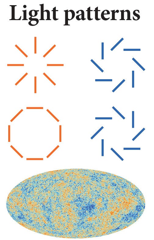

Light that oscillates in a preferred orientation is “polarized.” Scientists can tease out polarization patterns, like spokes on a wheel (E-mode, left) or swirls (B-mode), in the cosmic microwave background (CMB) that resulted from the distribution of matter in the early universe.
Astronomy: Roen Kelly; ESA/Planck Collaboration (CMB)

With sensitive detectors, like those on the South Pole Telescope, we can make maps of the polarization across the sky. At each location on the sky, we represent the polarization as a small stick, indicating its amplitude and orientation. We then use the patterns in these polarization maps to learn about the early universe (and also the later cosmos, but that’s a story for another time).
We can break down these polarization patterns into so-called “E-modes” and “B-modes.” E-modes represent radial patterns, like spokes on a wheel, while B-modes represent swirling patterns, like water flowing into a drain. We think that a period of hyperacceleration in the first moment of the universe, called the “inflation epoch,” generated B-mode polarization patterns. Earlier this year, the BICEP2 group reported the first detection of these B-modes, a discovery that (if confirmed) will have momentous implications for our understanding of the Big Bang.
