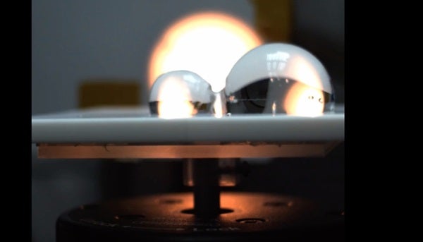

The problem is that at such small scales, droplets morph too quickly (within a millisecond) for detailed observations. That’s why the researchers of this new study sent their experiment to the microgravity environment of the ISS. This allowed the team to record video of much larger — and therefore more sluggish — water droplets as they merged.

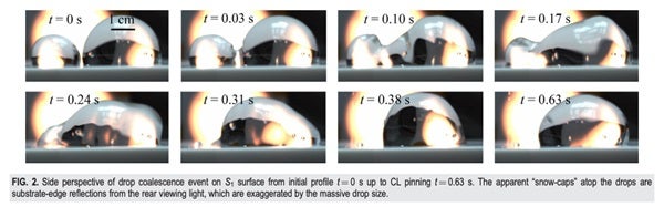

“NASA astronauts Kathleen Rubins and Michael Hopkins would deposit a single drop of desired size at a central location on the surface. This drop is near, but not touching, a small porthole pre-drilled into the surface,” said McCraney. “The astronaut then injected water through the porthole, which collects and essentially grows an adjacent drop. Injection continues until the two drops touch, at which point they coalesce.”
Waterdropletstimelapse
Josh McCraney
According to the study, “Upon coalescence (t=0.03 s), an immediate curvature gradient is observed at the liquid bridge, which induces a pressure gradient according to the Young–Laplace equation that gives rise to a capillary wave propagating laterally across the bridge. This process continues until t=0.24 s, at which point surface tension overwhelms inertia and the drop [contact line] begins to recede.” By t=0.63 seconds, the drop has dissipated enough energy through its motions that the contact line is pinned.
