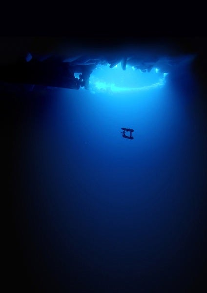

SeaBED, captured here on a test run under the Antarctic ice, is an autonomous underwater vehicle that can hover over Earth’s seafloor at depths of up to 6,000 feet (2,000 meters).
Klaus Meiners/Australian Antarctic Division ROV team

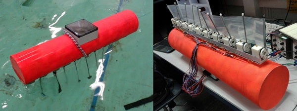

SquidROV, currently under development at the University of Edinburgh, is a biomimetic submarine propulsion system that uses a glassfish-style fin to get around. In addition to being more efficient than a propeller-based system, SquidROV (shown upside down on the right) also creates less turbulence.
