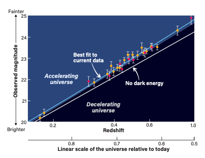

Type Ia supernovae have revealed much about the nature of our universe — including the fact that not only is it expanding, but it is doing so faster now than in the past. Astronomers have determined this by measuring the brightness of distant supernovae and plotting them against their redshift, a proxy for distance. The blue line shows the best fit to the current observations, which match the predicted model for a universe whose expansion is accelerating, rather than decelerating — i.e., a universe where dark energy contributes. The white line indicates how the brightness of supernovae would look with distance in a universe with no dark energy. It does not fit the observations, as it predicts that distant supernovae should appear brighter than they actually do.
Astronomy: Roen Kelly, after Carroll, Bradley W. and Ostlie, Dale A., An Introduction to Modern Astrophysics, 2nd Ed., Pearson Education, Inc., 2007.

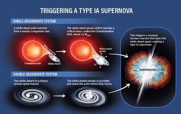

There are two leading theories on how to prompt a white dwarf to create a type Ia supernova, and both require the white dwarf to have a companion star that donates the extra mass to tip it over the limit and cause the explosion. The first is a single-degenerate (SD) system, where the white dwarf is in a close binary system with a fusion-burning star. (The “degenerate” here is the white dwarf, which, remember, is made of degenerate matter.) Over time, the white dwarf siphons material away from the star and, if it accretes enough material, it may reach the Chandrashekar mass and explode.
ScreenShot20221129at10.52.11AM
But in recent years, the SD scenario has run into some troubles — namely, it doesn’t appear to explain what we see in some type Ia supernovae. One notable example was supernova SN 2011fe, a quintessential type Ia explosion that occurred in the Pinwheel Galaxy (M101) in 2011, some 23 million light-years away. By type Ia supernova standards, it was right next door, and it was detected just hours after the explosion — the earliest a type Ia had ever been discovered. This allowed astronomers to search for evidence of a pre-existing companion star as well as any material in the system that was falling onto the white dwarf that exploded.
They found neither. According to a 2013 review of the supernova published in Publications of the Astronomical Society of Australia, written by Laura Chomiuk at Michigan State University, SN 2011fe’s environment was low density. So, there wasn’t considerable material available to collect onto the white dwarf and tip it over the weight limit into a supernova.
Instead, Chomiuk writes, “the data imply that SN 2011fe may have been the merger of two white dwarfs.” This is the second popular theory explaining type Ia supernovae: a so-called double-degenerate (DD) system, where there are two white dwarfs, presumably remnants from a stellar binary. Over many thousands of years — long enough for any gas and dust for the original system to disperse — the two are drawn together by gravity and eventually merge, creating the type Ia supernova.
The exact details are still debated — for one, it’s not clear whether a full merger into a single object is needed, or whether a contact touch between the two white dwarfs is enough. Some researchers even think such a system might not need to reach the Chandrasekhar mass — even if the two white dwarfs add up to less than 1.4 solar masses, the force of the collision could still trigger a runaway nuclear reaction and cause them to explode. Either way, it’s different enough from the SD scenario that a DD explosion would have a different signature, provided astronomers could see sufficient detail.
