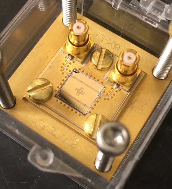

Special superconducting circuits used for quantum computing can help detectors sift through noise that might be hiding an axion signal.

In conventional axion detectors, the quantum noise from the uncertainty principle obscures both quadratures equally. This noise can’t be eliminated, but with the right tools it can be controlled. Our team worked out a way to shuffle around the quantum noise in the HAYSTAC detector, reducing its effect on one quadrature while increasing its effect on the other. This noise manipulation technique is called quantum squeezing.
In an effort led by graduate students Kelly Backes and Dan Palken, the HAYSTAC team took on the challenge of implementing squeezing in our detector, using superconducting circuit technology borrowed from quantum computing research. General-purpose quantum computers remain a long way off, but our new paper shows that this squeezing technology can immediately speed up the search for dark matter.

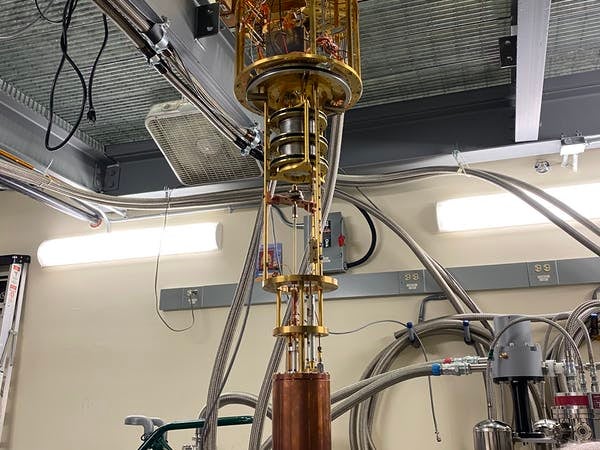

Cryogenic cooling helps reduce noise, but by squeezing quantum noise, the HAYSTAC detector can search for an axion signal even faster.
