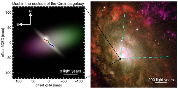

Using the MIDI instrument at the Very Large Telescope Interferometer (VLTI) of the European Southern Observatory (ESO) in the Atacama Desert of Chile, the research team obtained an unprecedented clear view of the warm dust in the nucleus of the Circinus Galaxy. At a distance of only 13 million light-years, the Circinus Galaxy contains one of the closest and brightest active galactic nuclei.
“We obtained at least twice the amount of interferometric data than for any other galaxy,” said Konrad Tristram from MPIfR. “Our observations make the Circinus Galaxy by far the best observed extragalactic source in optical and infrared interferometry.” By combining the light of two telescopes, the interferometric observations increase the resolution to that of a telescope of 302 feet (92 meters) in diameter.
In the case of the Circinus Galaxy, the scientists could for the first time show that the emission of the nuclear dust comes from two distinct components — an inner disk-like component and an extended component significantly elongated in polar direction. The dust disk in the Circinus Galaxy has a size of about 3 light-years and agrees well with a warped molecular disk revealed by water emission.
This inner disk is surrounded by a much bigger dust distribution with a size of at least 6 light-years. We only see the inner edge of this dust distribution, which is directly illuminated by the radiation coming from the central region. This inner funnel appears elongated in polar direction. Its southeastern side is significantly more obscured by dust than the northwestern side. This leads to the observed strong asymmetry and color change in the observed emission.
“From this, we deduce that it is the larger dust component, which is responsible for hiding the central engine and for collimating the visible ionization cone,” said Leonard Burtscher from the Max Planck Institute for Extraterrestrial Physics in Garching. “We can only see the inner, directly illuminated edges of that component. This is certainly in contrast to some earlier speculations.”
