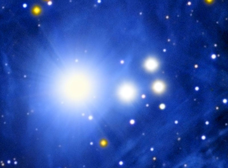

A bright star in the Pleiades (M45) creates some unwanted flare in this astroimage. All photos: Tony Hallas
Start by looking carefully at the star. Do you see how far the flare extends from its center? With the “Elliptical Marquee Tool” in Photoshop’s tool palette, hold down the shift key (to force a perfect circle) and draw a circular selection just inside the edge of the worst flaring. Now “Feather” (found under the “Select” menu) this selection about 40 to 60 pixels. Open “Curves” (in the “Image/Adjustment” menu) and pull down on the center of the curve until the density of the outer flare matches the surrounding areas. Careful — if you darken too much, you will end up with a dark circle.

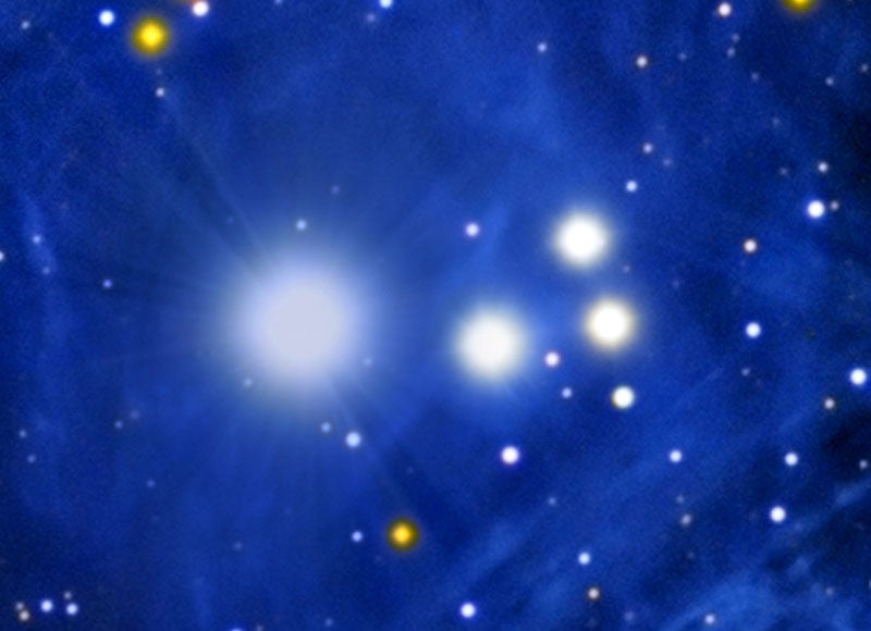

Darken the star by using Photoshop’s “Elliptical Marquee Tool,” “Feather,” and “Curves.” This will reveal detail under the flare.
Notice two interesting results: The hot core becomes smaller, and hidden detail beneath the flare begins to emerge. This is already a huge improvement, but we can go even further.

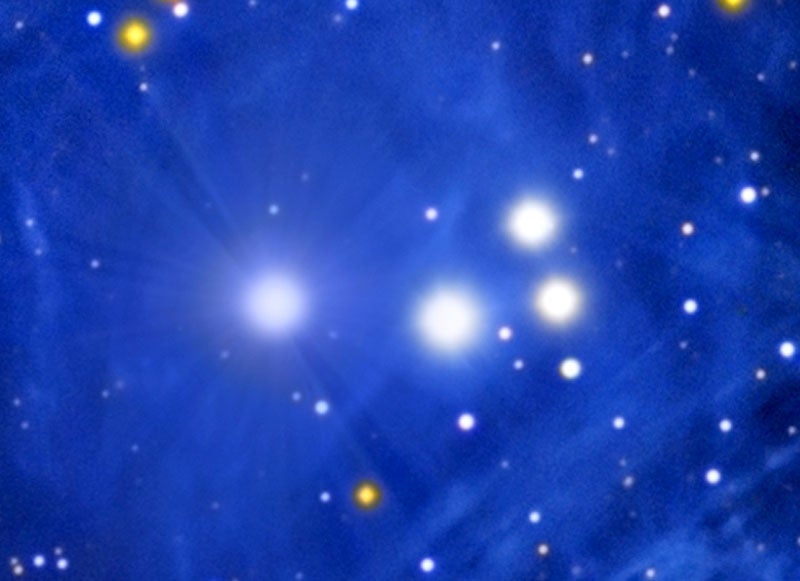

It’s possible to get all the stars to match (even unrealistically so) by darkening further and using the “Pucker Tool.”
Make another circular selection around whatever flare is left, feather, and darken again. Note that the core of the star might now be a shade of gray, or it might have assumed a spurious color. If this happens, use the “Clone Stamp Tool” in “Color” mode to return the star to the surrounding color.
Dodge the core of the star with the “Dodge Tool” in “Highlight” mode at a strength of 10 percent to bring the core back to white.
After finishing, you should see details that were previously covered up by the flare and a star that is more representative of its true luminosity. Remember, I took this technique to extremes to show you how well it can work. In real life, my adjustments would have been more modest.
