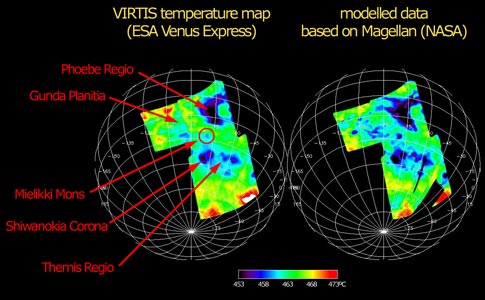

The temperature maps of the venusian surface shown in this image were built thanks to direct measurements obtained by Venus Express’ VIRTIS instruments (left), compared with surface-temperature predictions based on Magellan topographic data obtained in the early 1990s (right). VIRTIS, the Visible and Infrared Thermal Imaging Spectrometer aboard ESA’s Venus Express, gathered the data combined into this mosaic on August 10, 2006, during a single orbit.

The measurements, made in August 2006 over the Themis and Phoebe Regions in the southern hemisphere of Venus, reveal temperature variations of 30 degrees between lowlands and mountain tops, correlating well with existing topographical radar data from previous missions. The Themis Region is a highland plateau located at 270º East longitude and at about 37º South latitude. It is a region that has experienced strong volcanic activity, at least in the geologic past.
On Venus there are no day and night variations of the surface temperature. The heat is globally ‘trapped’ under the carbon-dioxide atmosphere, with pressure 90 times higher than on Earth. Instead, the main temperature variation is due to topography. Just like on Earth, mountain tops are colder, whereas the lowlands are warmer. The ‘only’ difference is that on Venus ‘cold’ means 447º Celsius, while ‘warm’ means 477º Celsius. Such high temperatures are caused by the strongest greenhouse effect found in the Solar System.

In order to achieve this, the Venus Express scientists started comparing the maps of the Venusian topography obtained by NASA’s Magellan orbiter in the early 1990s with the data gathered by VIRTIS. The Magellan topography maps allow for a rough prediction of the surface temperature, too. Comparing these predictions with the measurements made by VIRTIS allows searching for hot spots that show even higher temperatures than the oven-hot surface, possibly indicative of active volcanism.
This direct interdependence between temperature and topography will enable scientists to derive new topography maps of the Venusian surface from temperature measurements. This will help in complementing the Magellan maps.
“Actually, when comparing our temperature map with topographical data from Magellan, we are not only obtaining quite a good agreement, but we can even fill gaps that the Magellan and Venera 15 radar data sets left open”, concluded Pierre Drossart, the other Principal Investigator of the VIRTIS experiment, from the Observatoire de Paris Meudon, France.
