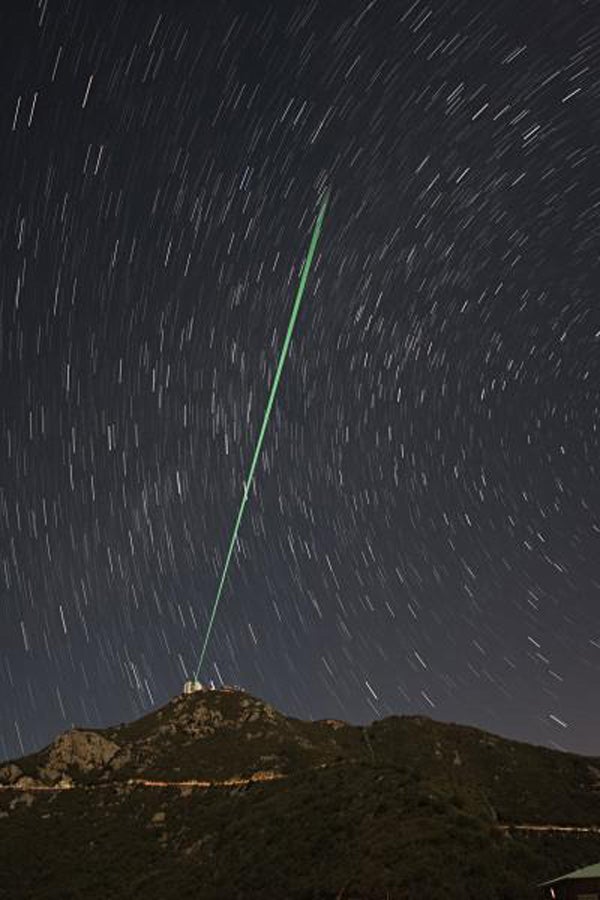

From their observatory on Mount Hopkins south of Tucson, Arizona, Hart and his group point a bundle of green laser beams into the night sky. Some of the laser light bounces off oxygen and nitrogen molecules high up in the atmosphere, creating five artificial stars spread across the field of view.
“We observe what the turbulence in the atmosphere does to them,” said Hart. “The light that is reflected back tells us what we need to know about the turbulence.”
