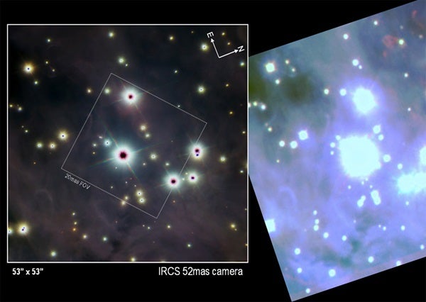

trapezium region in the Orion Nebula
An image of the trapezium region in the Orion Nebula with and without adaptive optics. The image on the right has a resolution of 0.6 arcseconds and was obtained with Subaru’s CISCO camera in 1999 without the use of adaptive optics. The image on the left has a resolution of 0.06 arcseconds and was obtained in October 2006 using Subaru’s IRCS camera and the new adaptive optics system.
Subaru Telescope
November 21, 2006
On October 9, 2006 the Subaru Telescope researchers used a new adaptive optics system to obtain an image of the Trapezium region of the Orion Nebula. A comparison of this new image with a first light image taken when the Subaru telescope first began observing in 1999, shows a dramatic increase in contrast and detail in the higher-resolution image. With the new system in place, including a newly installed laser guide star system, to measure and correct for the effect of turbulence in real-time, Subaru’s eyesight has been improved by a factor of ten, giving astronomers a clearer view of the universe.
