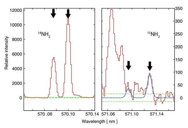

chart 1
Close-up of spectra of NH2 emission lines (of the same transitions for both 14NH2 and 15NH2) in Comet ISON, showing the difference in wavelengths and relative intensity between the isotopes. The red and green-dashed lines indicate the observed spectrum. The blue line indicates 15NH2, clearly detected for the first time.

A team of astronomers led by Yoshiharu Shinnaka and Hideyo Kawakita, both from Kyoto Sangyo University, successfully observed Comet ISON during its bright outburst in the middle of November 2013. Subaru Telescope’s High Dispersion Spectrograph (HDS) detected two forms of nitrogen — 14NH2 and 15NH2 — in the comet. This is the first time that astronomers have reported a clear detection of the relatively rare isotope 15NH2 in a single comet and also measured the relative abundance of two different forms of nitrogen — nitrogen isotopic ratio — of cometary ammonia (NH3). Their results support the hypothesis that there were two distinct reservoirs of nitrogen in the massive dense cloud — solar nebula — from which our solar system may have formed and evolved.

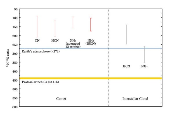

chart 2
Comparison of nitrogen isotopic ratios obtained from comets (left) and molecular cloud core (right). The blue line indicates the ratio of nitrogen isotopes in  Earth’s atmosphere while the wider yellow line indicates that of the protosolar nebula. The figure shows that the nitrogen isotopic ratios obtained from cometary molecules are similar to each other while those of HCN (hydrogen cyanide) and HN3 (ammonia) in the molecular cloud core are different.

The team used Subaru Telescope’s HDS to successfully observe Comet ISON on November 15 and 16 when the comet had its bright outburst that began on November 14. The observation clearly detected 15NH2 from Comet ISON, and the team inferred that the ratio of cometary ammonia of 14N/15N (139 ± 38) is consistent with the average (14N/15N about 130) of that from the spectra of 12 other comets. In other words, Comet ISON is typical in its relative abundance of 14N/15N in cometary ammonia.
These findings support the hypothesis that there were two distinct reservoirs of nitrogen in the solar nebula: (1) primordial N2 gas having a protosolar value of 14N/15N = 441 ± 5, and (2) less volatile and probably solid molecules having a ratio of about 14N/15N about 150 in the solar nebula. In the case of a dense molecular cloud core, the isotopic ratio of hydrogen cyanide (HCN) is similar to that of comets while its ratio in ammonia is different from its cometary value.
