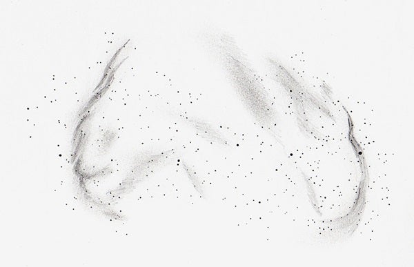

The second target for this month’s column is a supernova remnant called the Veil Nebula. Such an object marks the aftermath of an exploding star. The Veil Nebula is 1,400 light-years away in the constellation Cygnus the Swan. The entire complex spans nearly 3° and lies an equivalent distance south of Epsilon (ε) Cygni. Prominent segments include the Eastern Veil (NGC 6960), Pickering’s Triangle (NGC 6979), and the Western Veil (NGC 6992/5).
The remnant is a bit tough to see, but an Oxygen-III or Ultra High Contrast filter in a 10-inch or larger telescope will reveal it. You may see the entire loop through a low-power, wide-field eyepiece, but you’ll need to pan the area at higher magnifications to dig out the details. That means sketching multiple fields of view to capture the remnant.
Start by drawing a circle that represents each field. The circles overlap, and the collective finished sketch shows each field boundary. Alternatively, you can eliminate the constraints of sketch circles and opt for a clean, open-field drawing.
In the second case, sketch the field of view for an area containing a bright section of the Veil. Then nudge your telescope until roughly half the field disappears. The effect will be one where each field of view overlaps the previous one.
When you overlap, it enables you to cross-reference star fields while you’re sketching your way through the loop. And here’s a little-known tip: Your dark adaption will have increased during the observation, so to complete the sketch, make a final pass to include missed nebulosity and faint stars.
