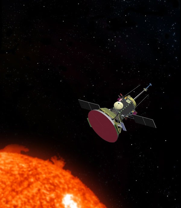

NASA has tapped APL to develop the ambitious Solar Probe mission, which will study the streams of charged particles the Sun hurls into space from a vantage point within the Sun’s corona — its outer atmosphere — where the processes that heat the corona and produce solar wind occur. At closest approach Solar Probe would zip past the Sun at 125 miles per second, protected by a carbon-composite heat shield that must withstand up to 2,600° F and survive blasts of radiation and energized dust at levels not experienced by any previous spacecraft.

APL will design and build the spacecraft, on a schedule to launch in 2015. The compact, solar-powered probe would weigh about 1,000 pounds; preliminary designs include a 9-foot-diameter, 6-inch-thick, carbon-foam-filled solar shield atop the spacecraft body. Two sets of solar arrays would retract or extend as the spacecraft swings toward or away from the sun during several loops around the inner solar system, making sure the panels stay at proper temperatures and power levels. At its closest passes the spacecraft must survive solar intensity more than 500 times what spacecraft experience while orbiting Earth.

Solar Probe will be fortified with heat-resistant technologies developed for APL’s MESSENGER spacecraft, which completed its first flyby of Mercury in January and will begin orbiting that planet in 2011. Solar Probe’s solar shield concept was partially influenced by designs of MESSENGER’s sunshade.
