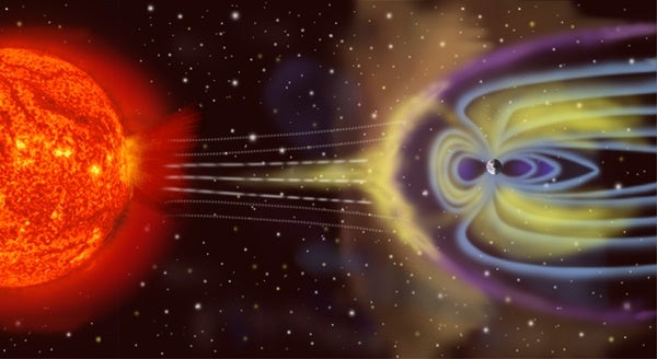

The first thing solar wind hits as it approaches Earth is the magnetosphere. This region surrounding the Earth’s atmosphere is filled with plasma made of electrons and ions. It’s dominated by the planet’s strong magnetic field. When solar wind hits the magnetosphere, it transfers mass, energy and momentum into this layer.
The magnetosphere can absorb most of the energy from the everyday level of solar wind. But during strong storms, it can get overloaded and transfer excess energy to the upper layers of Earth’s atmosphere near the poles. This redirection of energy to the poles is what results in fantastic aurora events, but it also causes changes in the upper atmosphere that can harm space assets.

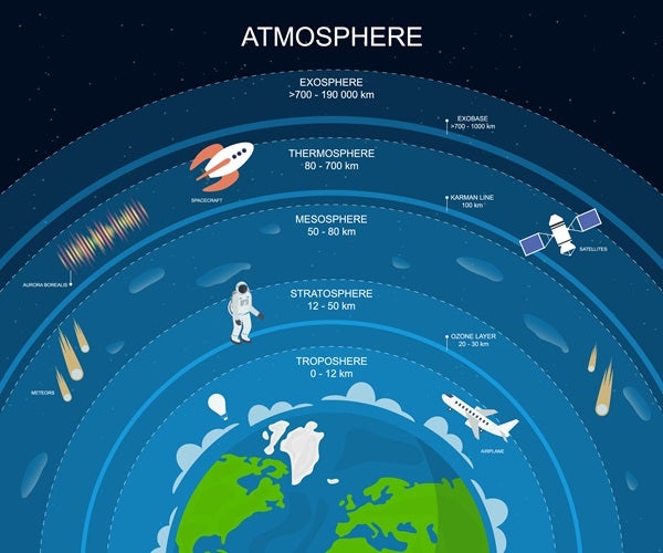

When the atmosphere absorbs energy from magnetic storms, it heats up and expands upward. This expansion significantly increases the density of the thermosphere, the layer of the atmosphere that extends from about 50 miles (80 kilometers) to roughly 600 miles (1,000 km) above the surface of the Earth. Higher density means more drag, which can be a problem for satellites.

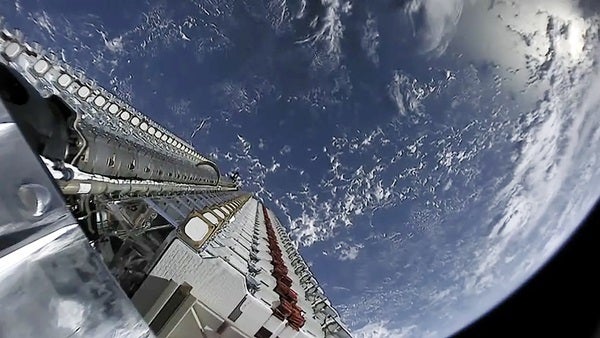

Starlink satellites are released in batches, and 40 were destroyed in early February because of a geomagnetic storm. SpaceX via WikimediaCommons
This situation is exactly what led to the demise of the the SpaceX Starlink satellites in February. Starlink satellites are dropped off by Falcon 9 rockets into a low-altitude orbit, typically somewhere between 60 and 120 miles (100 and 200 km) above the Earth’s surface. The satellites then use onboard engines to slowly overcome the force of drag and raise themselves to their final altitude of approximately 350 miles (550 km).
The latest batch of Starlink satellites encountered a geomagnetic storm while still in very low-Earth orbit. Their engines could not overcome the significantly increased drag, and the satellites began slowly falling toward Earth and eventually burned up in the atmosphere.
