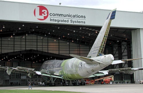

SOFIA returns to the hangar
SOFIA returns to the hangar after April 2004 pressure tests.
SOFIA / USRA

The SOFIA 747-SP aircraft, complete with a 98.4-inch (2.5 meter) infrared telescope, is rapidly nearing its first test flight. Under development for 8 years, NASA’s Stratospheric Observatory for Infrared Astronomy (SOFIA) has begun final installation and testing of the complex and challenging sliding Cavity Door system at L-3 Communications Integrated Systems in Waco, Texas. When operational (planned for late 2006) SOFIA will be the largest airborne observatory in the world.

Designing a door to open and close while flying in the stratosphere has been one of the many challenging engineering issues facing the SOFIA project. Flying a jumbo jet at 45,000 feet with a hole 19 by 14 feet wide (5.8 by 4.3m) in the rear fuselage is no easy task.

The Cavity Door consists of three parts: an Upper Rigid Door (URD); the aperture, a moveable segment that tracks with the telescope pointing; and a Lower Flexible Door (LFD). The aperture and LFD have independent drive systems that work under a single coordinated controller. Wind-sheer controllers ensure smooth airflow across the aperture.
The extra effort for completion of the door is now paying off, and, to the relief of scientists and engineers, the end is in sight. The Upper Rigid Door was successfully installed on December 18. The door installation is expected to be complete in January.
Once the door is completed, SOFIA will take its first flight since the telescope’s installation. Project managers plan to keep the door closed for the first five test flights, slated to begin in late February 2005.
