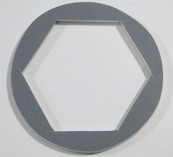

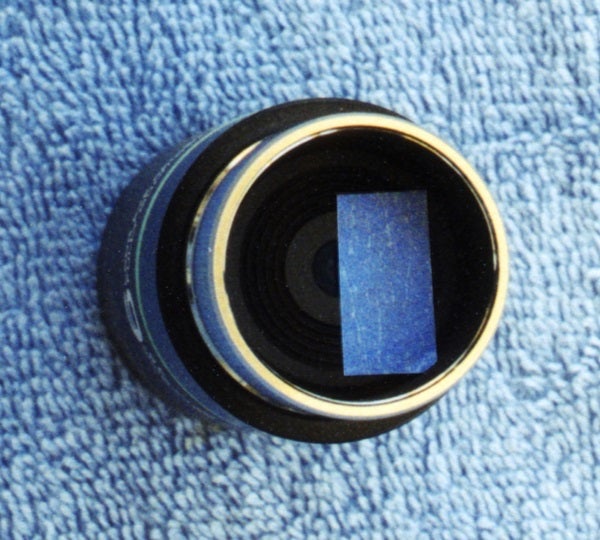

If the night is great but all my attempts fail, I’ll try two tricks of the trade used by experienced double star observers to ferret a faint companion out of the glare of a brilliant primary. One is using a hexagonal aperture mask to convert the bright star’s image into a six-spiked pattern. The dim partner may then appear between spikes. The other is to use an eyepiece with an occulting bar to cover the bright star, reducing its glare.
