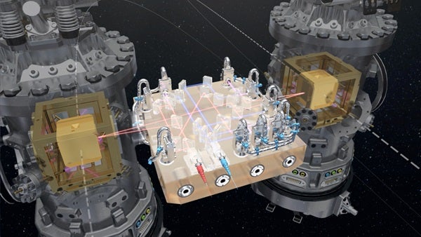

As tests on the spacecraft and its precious payload continue, a major milestone was reached Tuesday. For the first time, the two masses — a pair of identical 46 mm gold-platinum cubes — in the heart of the spacecraft are floating freely, several millimeters from the walls of their housings. The cubes sit 38 cm apart linked only by laser beams.
Throughout LISA Pathfinder’s ground handling, launch, the burns that raised its orbit, and the six-week cruise to its work site, each cube was held firmly in place by eight ‘fingers’ pressing on its corners.
On February 3, the locking fingers were retracted and a valve was opened to allow any residual gas molecules around the cubes to vent to space.
Each cube remained in the center of its housing held by a pair of rods softly pushing on two opposite sides.
Freely_Floating_in_space
LISA Pathfinder has two gold–platinum cube test masses at its core, which float freely from their housings and are linked only by laser beams to measure their position continuously. In the coming weeks, the spacecraft’s microthrusters will make minuscule shifts, centering itself on one of the masses to isolate the cubes from all external forces except gravity.
ESA/ATG Medialab
The rods were finally released from one test mass yesterday and from the other today, leaving the cubes floating freely, with no mechanical contact with the spacecraft.
