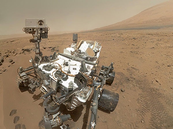

Curiosity's self-portrait
On Sol 84 (October 31, 2012), NASA’s Curiosity rover used the Mars Hand Lens Imager (MAHLI) to capture this set of 55 high-resolution images, which were stitched together to create this full-color self-portrait.
NASA/JPL-Caltech/Malin Space Science Systems
