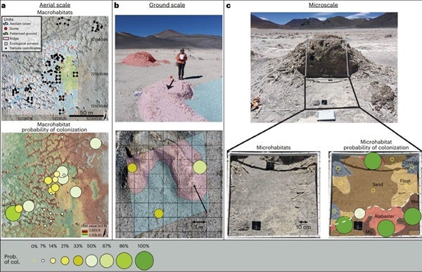

The new research was based on seeking life in a salt flat in the Atacama, where there is a variety of microbial life present. The team found that searching locations at random would produce evidence of life less than 10 percent of the time.
But using the new method they developed, which combines imagery and spectroscopy from satellites and drones that is then analyzed using machine deep learning, the researchers were able to predict search locations that yielded up to 87.5-percent success rates in finding life.

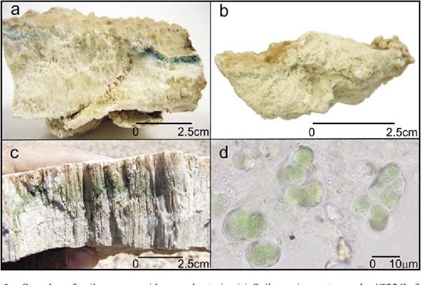

Gypsum soil has been shown to serve as a habitat for certain microbes like cyanobacteria. Panel (a) shows a gypsic crust sample taken from the Atacama Desert embedded with a streak of cyanobacteria. Hailiang Dong et al. (2007)
It turns out that the safest habitat for cyanobacteria, also known as blue-green algae, is inside desert rocks, particularly in a form of gypsum known as alabaster. When a piece of alabaster collected from promising locations is cracked open, it will typically reveal a greenish layer just below the rock’s surface — far enough inside to be protected from the deadly UV radiation, but close enough to the surface that the cyanobacteria still get enough visible light through the translucent rock to be able to carry out photosynthesis.

Warren-Rhodes and her colleagues searched for likely habitats at different scales, as seen in this diagram. Their results showed the odds of finding life could quickly drop even if shifting their such area just a few inches. Warren-Rhodes et al. (2023)

Warren-Rhodes points out that we already have very good tools — in the form of well-equipped orbiters currently circling Mars — for finding the larger-scale regions that could be of interest for biological searches. One such location is Jezero Crater, which is currently being explored by the Mars rover Perseverance. But within those large regions, there’s little to guide a rover to the best potential microhabitats.
“Once they’re on the ground, you have a lot of different choices, you have this whole landscape in front of you, like in the Atacama, and you get to pick like 10 places that you get to sample,” says Warren-Rhodes.
The new work, she hopes, will be a step toward developing a whole set of criteria for guiding that last bit of the exploration process. The team hopes that the process they used in Salar de Pajonales will be repeated in other places, including other Mars-analog sites on Earth, to develop a catalog of features and signatures to focus on when searching for life elsewhere.
After learning exactly what kinds of environments turned out to be most favorable as microhabitats, Warren-Rhodes says, she has learned to visually spot these places on the ground. This means she can walk straight to a spot of interest, pick up a rock, and have high confidence she’ll find microbial life inside. The team hopes that this kind of research will provide a similar headstart for future Mars rover planners as they search for the best places to sample.
