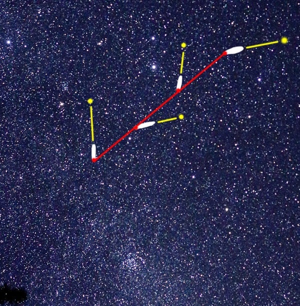

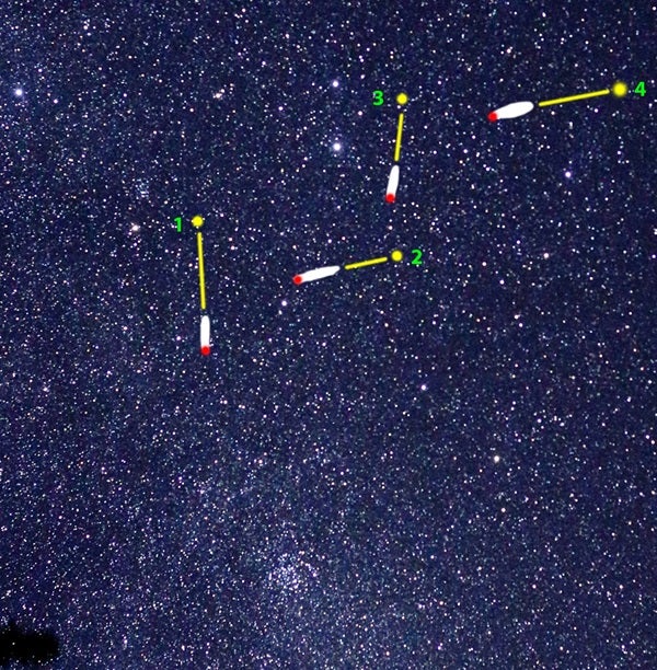

The author added the colored dots, lines, and numbers to this photograph. The red dots show where the flashes appeared to him. The white lines give the expected direction of motion. The yellow dots show the expected location of the next event for each object.
Both illustrations: Stephen James O’Meara

It started with a prolonged, elongated flash lasting long enough for me to detect its direction (along the major axis of the flash). Scanning my eyes in the direction of motion, I waited for the next event. To my surprise, it occurred well below and to the right of the first flash, causing me to believe it was a different object.
ASYOM0618_02copy
This illustration shows the true path of the satellite (the red line) through the stars. Although the events seemed disjointed to the author, the appearance of each flash (the red dots in the above image) proves the object was moving in a straight line.
The second flash also was elongated, and appeared to travel perpendicular to the first satellite. So, now I had two satellites to follow. A third elongated flash occurred in an unexpected location in the sky, followed by a fourth seemingly unrelated flash.
The first photo-illustration (above, top) shows the location of the flash (red), the direction of elongation (white), and the expected location of the next event (yellow) for each object. After the fourth flash, however, it became clear that the satellite was, in fact, moving as it should: on a straight and steady course, but tumbling in a way so that its rotation axis was not aligned with its principal axis.
If the object itself were elongated, like a rocket body, this could explain the “fake out,” as sunlight slid along the length of the body. The second photo-illustration (above, bottom) shows that if you connect the red dots, the satellite is indeed moving along a straight line.
