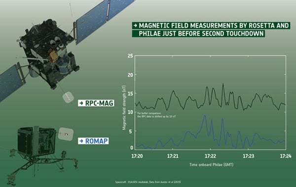

Philae’s magnetic field measuring instrument is the Rosetta Lander Magnetometer and Plasma Monitor (ROMAP), while Rosetta carries a magnetometer as part of the Rosetta Plasma Consortium suite of sensors (RPC-MAG).
Changes in the magnetic field surrounding Rosetta allowed RPC-MAG to detect the moment when Philae was deployed in the morning of November 12, 2014.

“The unplanned flight across the surface actually meant we could collect precise magnetic field measurements with Philae at the four points we made contact with and at a range of heights above the surface,” said Hans-Ulrich Auster from Braunschweig University of Technology in Germany.
The multiple descents and ascents meant that the team could compare measurements made on the inward and outward journeys to and from each contact point and as it flew across the surface.
ROMAP measured a magnetic field during these sequences but found that its strength did not depend on the height or location of Philae above the surface. This is not consistent with the nucleus itself being responsible for that field.
“If the surface was magnetized, we would have expected to see a clear increase in the magnetic field readings as we got closer and closer to the surface,” said Hans-Ulrich. “But this was not the case at any of the locations we visited, so we conclude that Comet 67P/Churyumov-Gerasimenko is a remarkably non-magnetic object.”
Instead, the magnetic field that was measured was consistent with an external one, namely the influence of the solar wind interplanetary magnetic field near the comet nucleus. This conclusion is confirmed by the fact that variations in the field that were measured by Philae closely agree with those seen at the same time by Rosetta.
“During Philae’s landing, Rosetta was about 17 kilometers [11 miles] above the surface, and we could provide complementary magnetic field readings that rule out any local magnetic anomalies in the comet’s surface materials,” said Karl-Heinz Glassmeier from Braunschweig University of Technology.
If large chunks of material on the surface of 67P/Churyumov-Gerasimenko were magnetized, ROMAP would have recorded additional variations in its signal as Philae flew over them.
