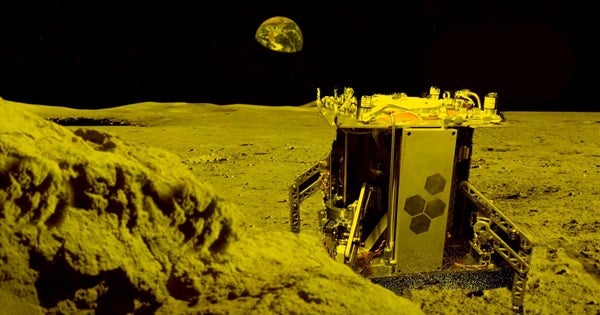

steampoweredspacecraft21200x630
The World is Not Enough (WINE) is a prototype spacecraft that will harvest water from targets and use that water to create steam that it will use as fuel.
University of Central Florida/Video Blocks/Victor Tangermann
Thanks to a mashup of science and industry, researchers have developed a prototype spacecraft that can mine water from an asteroid, use that water to generate steam, then use that steam as fuel to hop across the surface of an asteroid — or even jump to an entirely different world altogether.
The prototype spacecraft — named The World Is Not Enough (WINE) — was largely developed by Honeybee Robotics in Pasadena, California, with plenty of help from planetary scientist Philip Metzger of the University of Central Florida.
“The project has been a collaborative effort between NASA, academia and industry; and it has been a tremendous success,” said Kris Zacny, Vice President and Director of Exploration Technology at Honeybee Robotics, in a press release. “The WINE-like spacecrafts have the potential to change how we explore the universe.”
Previously, other teams have tested the specific subsystems needed for a steam-propelled spacecraft to perform In-Situ Resource Utilization (ISRU), which is the practice of producing necessary resources from only locally available materials. However, according to Zacny, WINE is the first prototype to successfully show it can combine all the technology necessary for ISRU and steam propulsion: It heated the analog asteroid regolith, extracted water, and then used that water to create enough steam to propel itself right off the ground.
