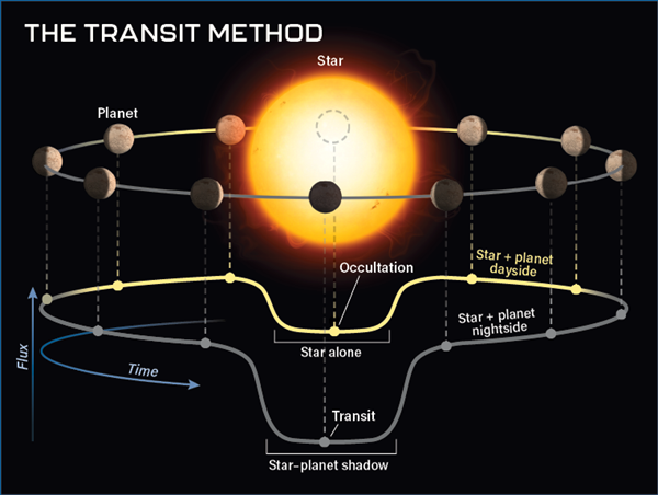

When a planet crosses the face of a star, there is a slight dimming in the brightness of that star measured from Earth. This principle is used to identify exoplanets orbiting other stars.

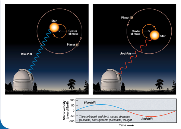

Astronomers have several ways to find planets circling other stars. One is the radial velocity method, which measures the way a star “wobbles” to and fro on the sky as an orbiting planet tugs on its sun. This wobble affects the wavelength, or color, of light we receive from the star, making it appear redder or bluer, depending on the direction of motion.

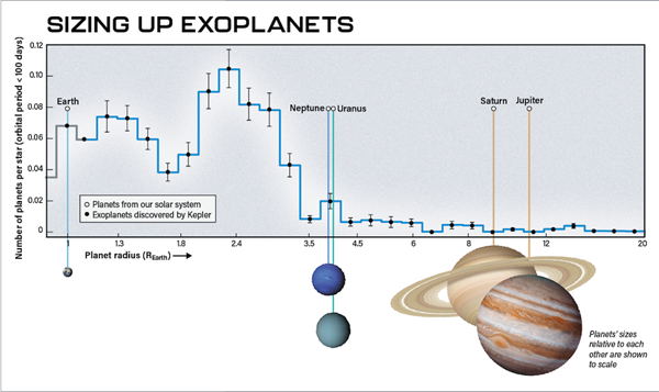

It turns out that the most common type of planet in the Milky Way is one that does not exist in our own solar system, with a radius between that of Earth and that of a planet like Neptune, four times larger than Earth. Members of this new class of planets are known as super-Earths, if their density suggests that they are rocky, or mini-Neptunes, if a lower density indicates a gaseous nature. Ideally, we’d know not only the radius, which can be determined by the transit method, but also the mass, for which we need a detection via radial velocity.

Actually, this exercise reveals another new truth about the planetary population. There’s a distinct absence of planets with sizes right in the middle of the gap between Earth and Neptune; at 1.7 Earth radii, in particular, there are few planets, a feature that has become known as the radius valley. It seems that planets really are either a super-Earth or a mini- Neptune, lying on one side of the valley or the other. The explanation comes from the time when planets are still forming. As the star heats the disk, only the most massive planets can hang onto their atmospheres. If the forming planet is not massive enough, its atmosphere is lost and it will end up as a super-Earth, while the more massive worlds can hang onto the gas and remain mini-Neptunes.
The details of these processes, and how they might have influenced our own world’s formation, are still being worked out, but the existence of this fundamental division between planetary types which we were completely oblivious to until a few years ago gives you an idea as to how fast things are changing. Careful observations of planets on both sides of the radius valley, along with their stars, will be a big part of astrophysics in the next decade or so.
