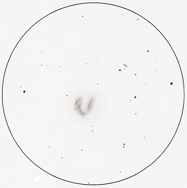

This is original scan of Antennae (NGC 4038/9) sketch.
This image is the author’s original scan of her Antennae (NGC 4038/9) sketch, which she completed while observing through a 16-inch reflector with an eyepiece that yielded a magnification of 225x.

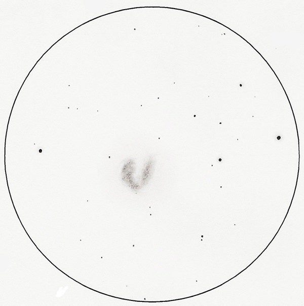

This image is the sketch of Antennae (NGC 4038/9) after the author used software to clean it up.
This image is the same sketch after the author used software to clean it up. She removed stars in the wrong places, corrected the shapes of elongated stars, added some glows around bright stars, and adjusted the overall contrast.
Do the same to elongated stars so that you shorten them without changing their magnitudes. You can use the “Blur” tool for uneven blending within the bodies of galaxies or when working with nebulosity.
To softly illuminate the brighter stars, use the “Eyedropper” tool to match the stars’ colors. Then select a soft, round brush with minimal opacity to produce the star glow. The brush’s size should be slightly larger than the star.

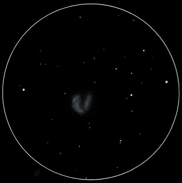

Next, invert the sketch so the stars will appear white against a black background. If the contrast isn’t correct after inverting, you can adjust it with “Curves,” “Brightness/Contrast,” or the “Exposure” setting. Be careful that you don’t lose nebulosity or faint stars in the process. Finally, you can add star color with the “Color Replacement” tool.
Erika Rix used Photoshop to invert her processed sketch and depict her view through the eyepiece (white objects against a black sky).
As a final step, the author used Photoshop to invert her processed sketch and depict her view through the eyepiece (white objects against a black sky).
