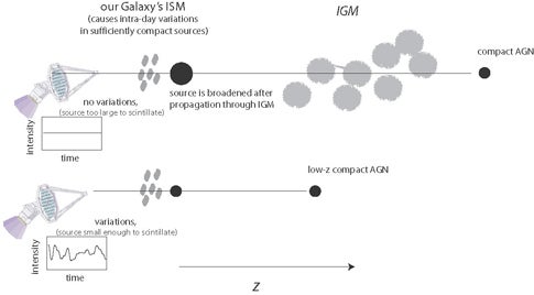

A schematic diagram of IGM broadening of z>2 quasar’s apparent size.

But now Ojha et al. have used the ISM &mdash the “minestrone” in our Galaxy — as a special kind of filter to distinguish between distant compact radio sources — quasars — on the basis of their angular size. And above a redshift of 2, the angular size of the sources appears to increase. Ojha et al. argue that this apparent increase in size is not due to the intrinsic nature of the sources or some trick of cosmology, but rather that it is the result of the quasars’ radio emission being scattered by a turbulent and ionized IGM.

The most likely explanation of these results is that an ionized IGM is diffusing the radio emissions from the quasars, causing them to appear larger than the angular size below which they can twinkle. A terrestrial analogy would be the way fog or heavy snowfall diffuses the headlights of distant oncoming cars at night. At z>2 the Universe was much smaller than it is today, so the intergalactic medium must have been much denser, overall, than it is now. Hot young stars, radio galaxies, and quasars, all present in abundance at this epoch, would have been “ionization factories” pumping out both ionizing radiation and charged particles. “We believe, therefore, that we’re seeing the effect of the radio signals being scattered by the ionized intergalactic medium,” said Dr. Jauncey. “But to confirm this result, we really need to get more redshifts, particularly for weaker sources, so that we can rule out any possible selection effects,” said Dr. Pursimo.
