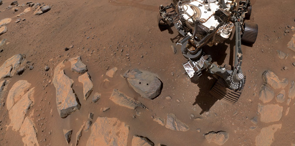

Perseverance took a selfie next to its biggest accomplishment yet – the two small drill holes where the rover took samples of Martian rocks.
NASA/JPL-Caltech/MSSS

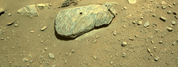

Perseverance has already cached two samples of Martian rocks after drilling cores out of a rock, the first of which is the hole seen here.
NASA/JPL-Caltech

One of Perseverance’s primary objectives is to use its sample caching system to extract small rock cores – roughly the size of dry-erase markers – and seal them in special sample tubes. A future mission will then pick them up and bring them on a long, interplanetary journey back to Earth.
For Perserverance’s first drilling attempt in August, our team picked a nice flat rock that was easy to access with the drill. After six days of assessing the bedrock – and finally drilling into it – we were thrilled to see a hole in the ground and get confirmation that the sample tube had sealed successfully. However, the next day the rover sent photos of the inside of the tube, and we saw it was actually empty. Some of Mars’ atmosphere is trapped inside and will be useful to study, but it’s not what the team was hoping for.
Ultimately, our team concluded that the rock itself was much softer than expected and it was completely pulverized during the act of drilling.
Three weeks and 1,800 feet (550 meters) later, we came across some promising-looking rocks protruding up above the red surface. This suggested that the rocks were harder and therefore easier to take a sample of. This time Perseverance successfully extracted and stored two core samples from the grayish, wind-polished rock. After collecting up to a few dozen more, it will drop the samples at a safe and easily accessible location on Mars’ surface. NASA’s Mars Sample Return mission, which is currently in development, will pick up the sample tubes in the late 2020s and bring them home.

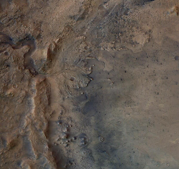

A delta in Jezero Crater, seen in this satellite image, is where Perseverance will collect the majority of its samples.
ESA/DLR/FU-Berlin

NASA selected Jezero Crater as Perseverance’s landing site specifically because it gives the rover access to a large stack of rocks that sits at the end of a dry river valley. Based on satellite images, scientists think that these rocks are made of sediment deposited by an ancient river that flowed into a lake roughly 3.5 billion years ago. If true, this location could have been an excellent environment for life.
However, the resolution of the satellite data isn’t high enough to say for sure whether the sediments were deposited slowly into a long-lived lake or whether the structure formed under drier conditions. The only way to know with certainty was to take images from the surface of Mars.

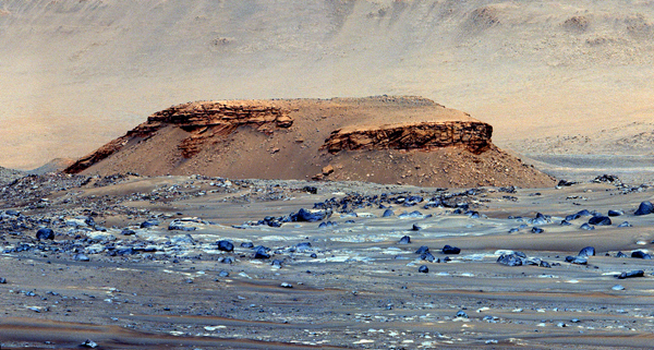

This structure of boulders and sediment shows the geological history of the delta.
NASA/JPL-Caltech/ASU/MSSS

When the images got back to Earth, we saw tilted layers of sediments in the lower parts of the 260-foot-tall (80 meters) cliffs. Toward the top we spotted boulders, some as large as 5 feet (1.5 meters) across.
From the structure of these formations, our team has been able to reconstruct a geological story billions of years old, which we published in the journal Science on Oct. 7, 2021.
For a long time – potentially millions of years – a river flowed into a lake that filled Jezero Crater. This river slowly deposited the tilted layers of sediment we see in the cliffs of the delta. Later on, the river became mostly dry except for a few big flooding events. These events had enough energy to carry big rocks down the river channel and deposit them on top of the older sediment; these are the boulders we see atop the cliffs now.
