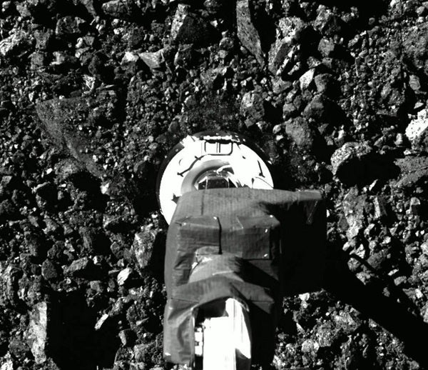

The craft navigated a boulder-strewn landscape down to the surface of Bennu, an asteroid more than 200 million miles (322 million kilometers) from Earth. The spacecraft’s cylindrical sample collection head, mounted to a robotic arm, pressed into the regolith — the surface layer of dust and rocks — for six seconds. Meanwhile, it fired a canister of nitrogen gas, which whisked material into a collecting area inside the rim of the sample head.
OSIRIS-REx (short for Origins, Spectral Interpretation, Resource Identification, and Security-Regolith Explorer) documented this feat in a spectacular video. As it approached the landing site, the craft’s nitrogen canister and retrorockets kicked up a cloud of rubble.

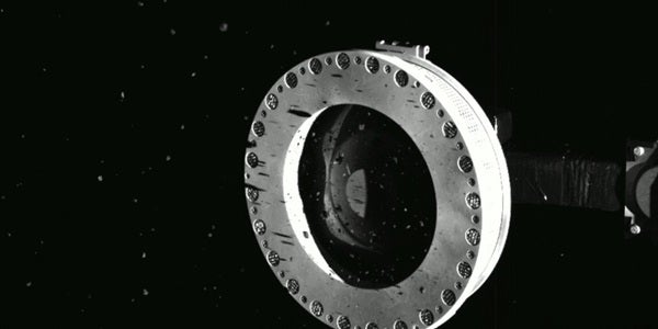

On Thursday, mission engineers moved the head of OSIRIS-REx’s Touch-and-Go Sample Acquisition Mechanism (TAGSAM) in front of the craft’s cameras to evaluate their asteroid haul. Rocks were plainly visible inside the collection head — at least 400 grams (almost 0.9 pounds), they estimate.
But the team also saw something concerning: the mylar flap meant to seal those precious rock samples is stuck open. A handful of Bennu particles just a few centimeters wide are wedged between the flap and the sample head’s inner rim. Furthermore, timelapse imagery shows that some invaluable pebbles are escaping into space.

OSIRIS-REx’s sample collection head is seen here with Bennu particles wafting out. The head’s mylar flap (black bulge to the left of the inner rim) is visibly wedged open

It appears the TAGSAM head is stuffed full and literally overflowing.
In one sense, that’s good news. It means OSIRIS-REx collected even more material than is visible — perhaps up to two kilograms (4.4 pounds). “It’s very exciting, very surprising, but overall excellent news,” Lauretta said at a press briefing on Friday, October 23, which NASA announced with less than an hour of advanced notice.
Still, the fact that these samples are leaking out is an unwelcome development. “It’s more than I’m comfortable with,” Lauretta added. “I was pretty concerned when I first saw these images.”

When TAGSAM touched down, the craft’s momentum continued to carry it inside the asteroid, plunging its head about 19 inches (48 centimeters) into the surface. The regolith barely resisted the intrusion, too, simply flowing around probe. That was much deeper than the team simulated, and probably explains why the TAGSAM got so full of material in the first place, said Lauretta.
